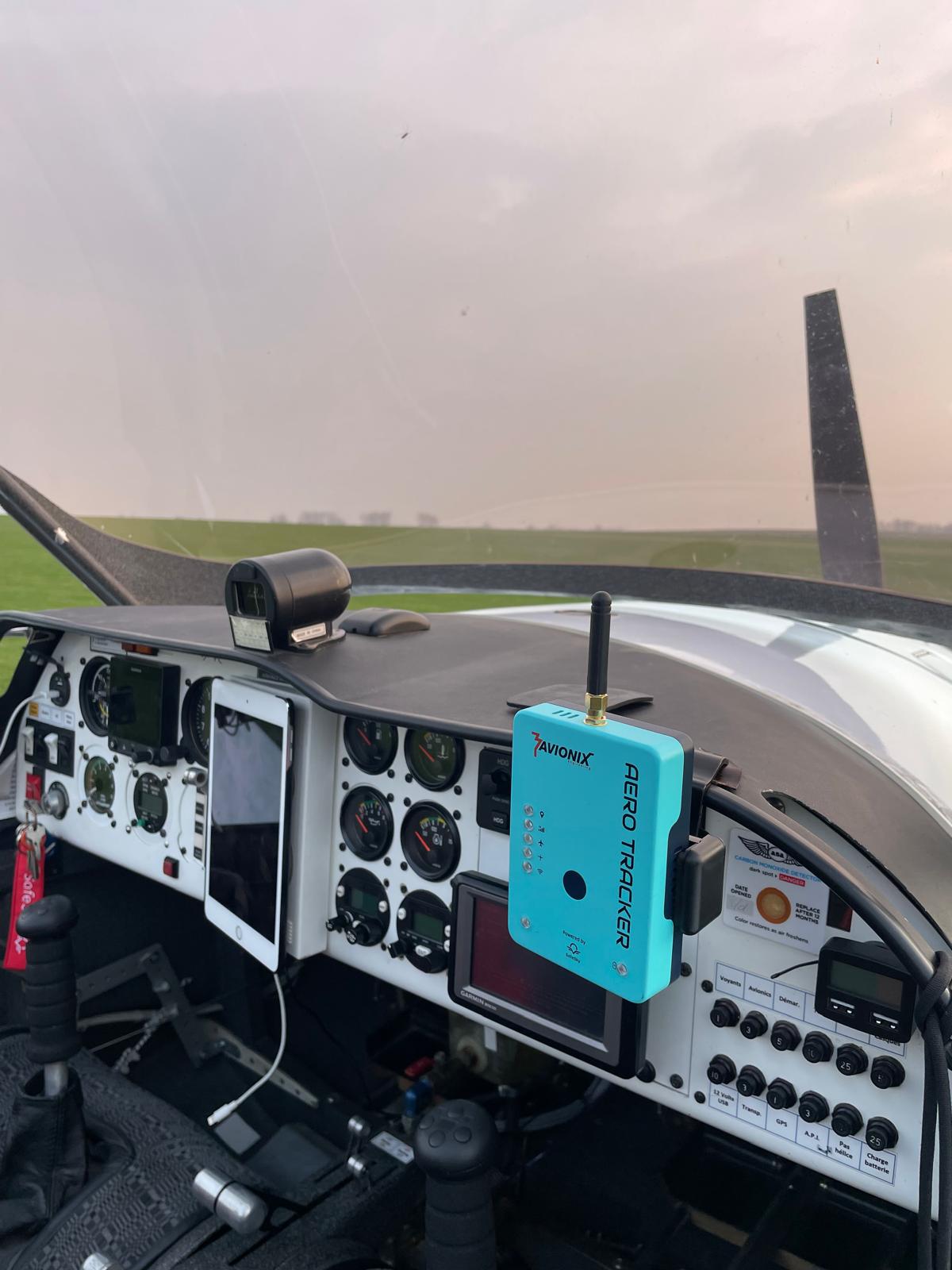

What is the best way to install the Aero Tracker?
For optimal performance, install the Aero Tracker in a vertical position with a clear view of the sky.
  • Mount it vertical inside your aircraft.
  • Make sure there are no obstacles above it, such as metal surfaces or dense materials, which could interfere with the GPS and transmission signals.
  • Avoid placing it under seats, dashboards, or near high-power electronics.
Proper placement ensures maximum tracking accuracy and consistent communication with SafeSky.

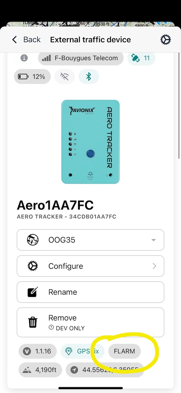

How to confirm that FLARM is active?
To verify that your Aero Tracker has FLARM enabled:
  1. Open the SafeSky App.
  2. Go to the "External Traffic" menu and select your Aero Tracker.
  3. Check the device status screen: you should see a "FLARM" label displayed if the license is active.

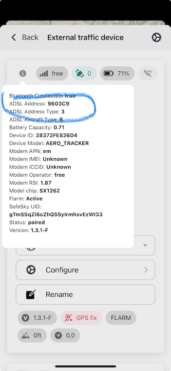

  1. Go to http://wiki.glidernet.org/ddb.
  2. Retrieve your Aero Tracker Device ID:
    • Connect to your Aero Tracker.
    • Tap the information icon (ℹ️) in the top-left corner.
    • Your ADSL Address corresponds to your Device ID on OGN.
    • Your ADSL Address Type corresponds to your Device Address Type on OGN.
  3. Enter your ADSL Address as the Device ID in the OGN registration form.
  4. If the Address Type is 2, select OGN. Otherwise, select ICAO.
