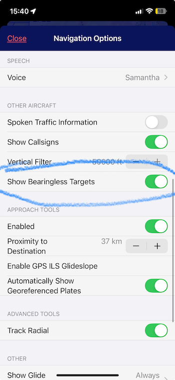

You can take advantage of the latest NMEA over Bluetooth feature for seamless integration with SkyDemon.
To visualize Mode-S traffic in SkyDemon, you need to enable it:

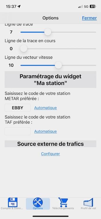

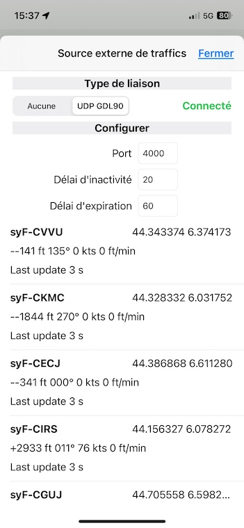

- Open SDVFR and go to Settings.
- Under Options, configure the traffic source to GDL90.
- If your Aero Tracker is placed outside and has GPS fix, you should see traffic appear in the list, similar to the screenshot below.

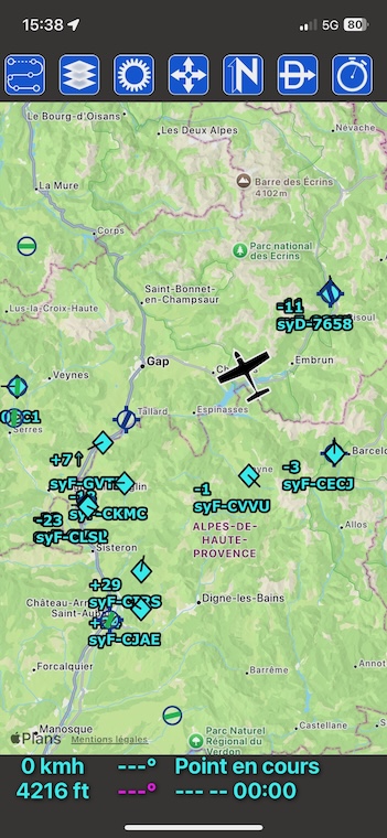

- Return to the main screen of SDVFR: nearby traffic should now be displayed on the map.

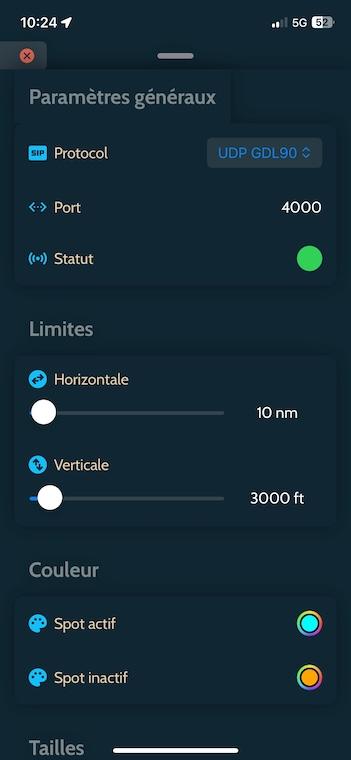

3 - SDVFR Next
Steps to Connect:
- Connect your phone or tablet to the Aero Tracker’s Wi-Fi hotspot (name starts with "AERO").

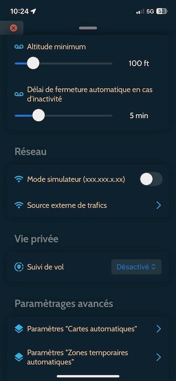

- Open SDVFR Next and go to Settings.
- In the Réseau section, tap Source externe de trafics.
- Enable GDL90 as the protocol: the "Status" should turn from red to green
- Set the horizontal filter to your desired range and the vertical filter to your desired altitude

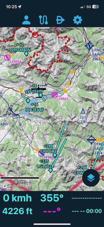

- Return to the main map screen: nearby traffic from both LTE and air-to-air sources should now be displayed.
