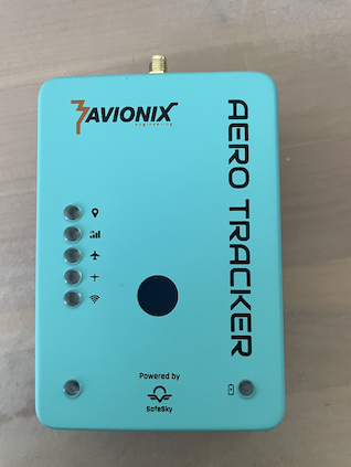

What do the Aero Tracker LED indicators mean?
The Aero Tracker uses a vertical strip of LED lights to communicate its current status.
Each LED represents a different function or state. When powering on, the LEDs will animate to indicate the device is booting.
Below is a general guide to the LED behaviour from top to bottom:
Documentation will be updated shortly
