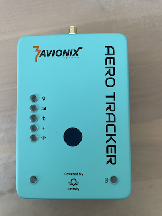

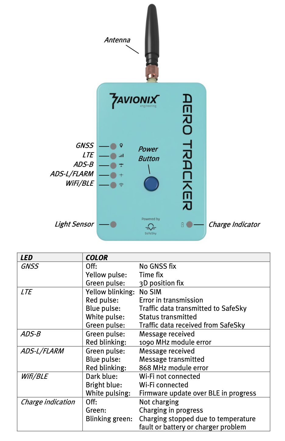

What do the Aero Tracker LED indicators mean?
The Aero Tracker uses a vertical strip of LED lights to communicate its current status.
Each LED represents a different function or state. When powering on, the LEDs will animate to indicate the device is booting.
Below is a general guide to the LED behaviour from top to bottom:
  • GPS Fix (Blue LED):
    • Solid blue = GPS fix acquired.
  • 📶 LTE Connection (Yellow LED):
    • Solid yellow = LTE connected.
    • Blinking yellow = attempting to connect.
  • 🔄 Air-to-Air 1090Mhz Reception (Red LED):
    • Flashing red = receiving traffic from other aircraft.
    • No red = no traffic detected via air-to-air.
  • 🔄 Air-to-Air 868Mhz Reception (Red LED):
