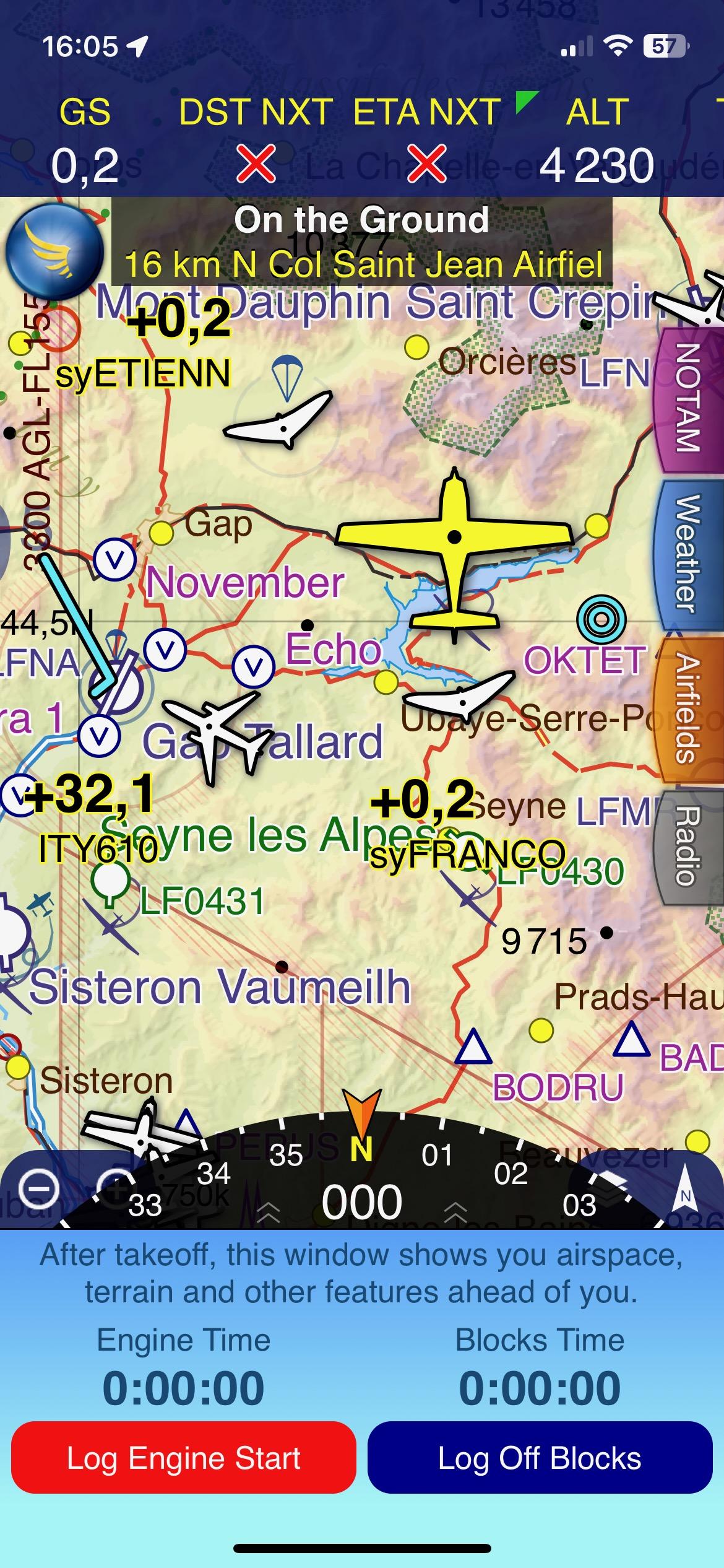

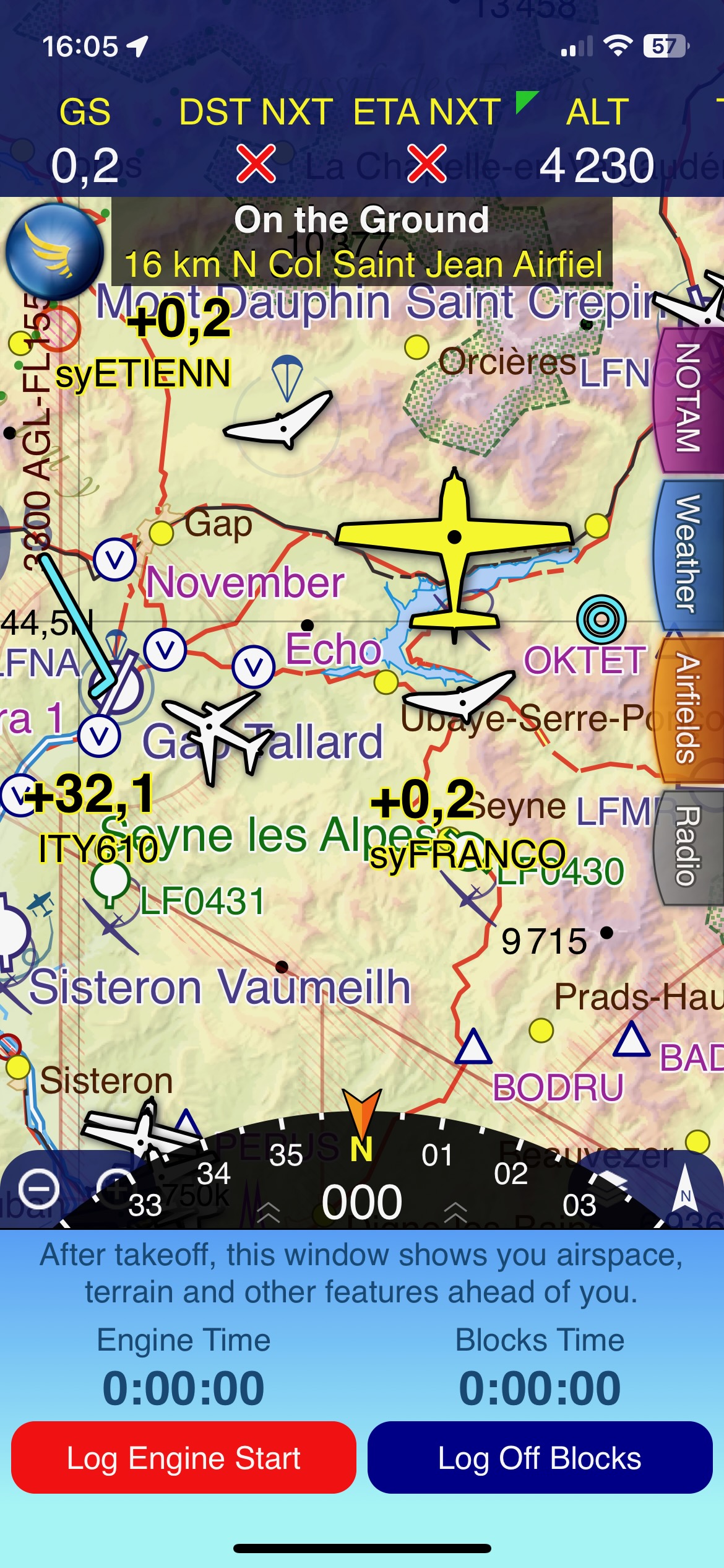

    How can I distinguish between SafeSky traffic and air-to-air traffic?
    You can enable the "Highlight SafeSky traffic" option in the Aero Tracker configuration to visually differentiate between the two sources of traffic.
    • When activated, traffic coming from the SafeSky network will appear with a 'sy' prefix in the callsign.
    • Air-to-air traffic will continue to display its normal callsign without any prefix.
    ⚠️ We do not recommend activating this feature while flying, as it might be confusing during high workload situations.
    To enable this option:
    1. Turn ON your Aero Tracker.
    2. Open the SafeSky App and go to the "External Traffic" menu.
    3. Select your Aero Tracker device from the list.
    4. Tap "Configure" and enable the "Highlight SafeSky traffic" setting.
    When sharing traffic with your EFB, the result will look like this:
