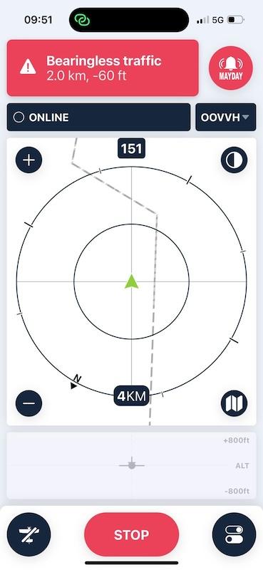

1 - SafeSky App
In SafeSky, Mode-S traffic will not appear on the radar view, but will appear as a popup on the screen:

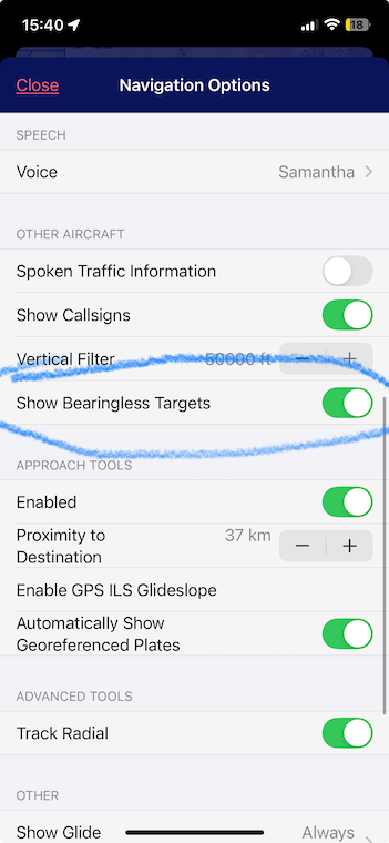

2 - SkyDemon
First, make sure that under "Navigation Options", the option "Show Bearingless Targets" is turned on.

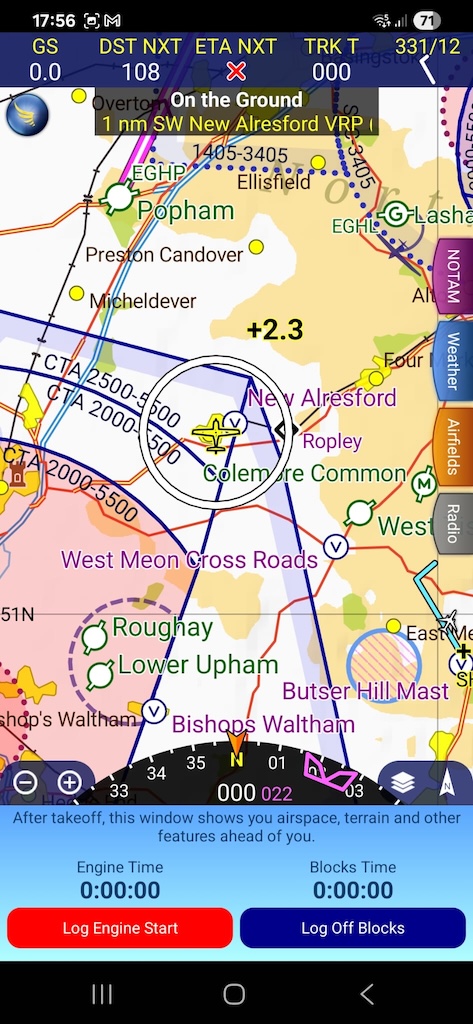

Then, from SkyDemon, Mode-S traffic will appear as a circle indicating the approximate distance from you and the aircraft.
